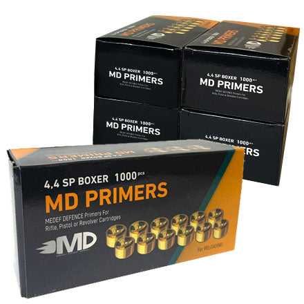

Regarding primers, another person here posted the link to this:
MEDEF Small Pistol Primers Free Ship & Haz - 5000ct
These Small Pistol Primers are made by MEDEF Defense, a Turkish manufacturer known for quality, consistency and affordability. MEDEF is now offering civilian reloaders high-quality components they can rely on to perform.americanreloading.com
I took a chance on this brand and ordered it. Worked out to be $0.044 per primer.
The 5,000 primers arrived this week and I loaded and fired the first 100 today and they seemed to work fine.
Ive never bought any discount off brand primers that didn't have issues. Those aren't even that cheap Ive found Winchester SPP for around that price in the last 6 monthsJust an update on these primers... I've had two failure to fire instances out of the first 500 rounds I reloaded with these primers. Different guns and the primers were definitely struck.
Never had this happen with the other primers I've used, so they seem to be just okay. They also seem softer than the primers I've used in the past.
So, just a heads up if you were considering them. They were cheap and I only use them to reload range ammo. I wouldn't use these for anything else.

miwall was down to 180 a bit ago but they are 220 right now. If you factor in the components you lose when you get duds it's worth it to get primers that go bang I feelWinchester SPPs for $0.04? Nice.
Fair enough, I used to try to save them but funny enough I just don't get duds anymore haha. Even just practicing I find it really annoying to get duds because you never know if it's going to be a squib, so you gotta stop and pay attention when you eject it and it ruins my rhythmReally only out the primer and 4.7gr of Win231 for me. I pull the bullet and reuse it and the brass. But I see your point.
