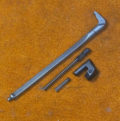

Yea, I didn’t strip the bolt. I don’t have the tool. the extractor moves and I blasted it with carb cleaner, air, brush, CLP, ultrasonic etc. the spring seemed on the weaker side to me though. I could move the extractor with my finger not hurting all that much.
I’m about to order this and try to find someone to help me instal it.

If you can find a NOS extractor and plunger spring (the shorter spring), just buy that instead of complete kit. Don't really "need" the tool, but it helps. Might need a third hand, but press in the ejector and use 1/8" punch to press the extractor shaft on bottom side of bolt.

I used to have the same problem as you. Replaced the entire ejector kit with a new set along with the ejector clip spring and problem was solved
